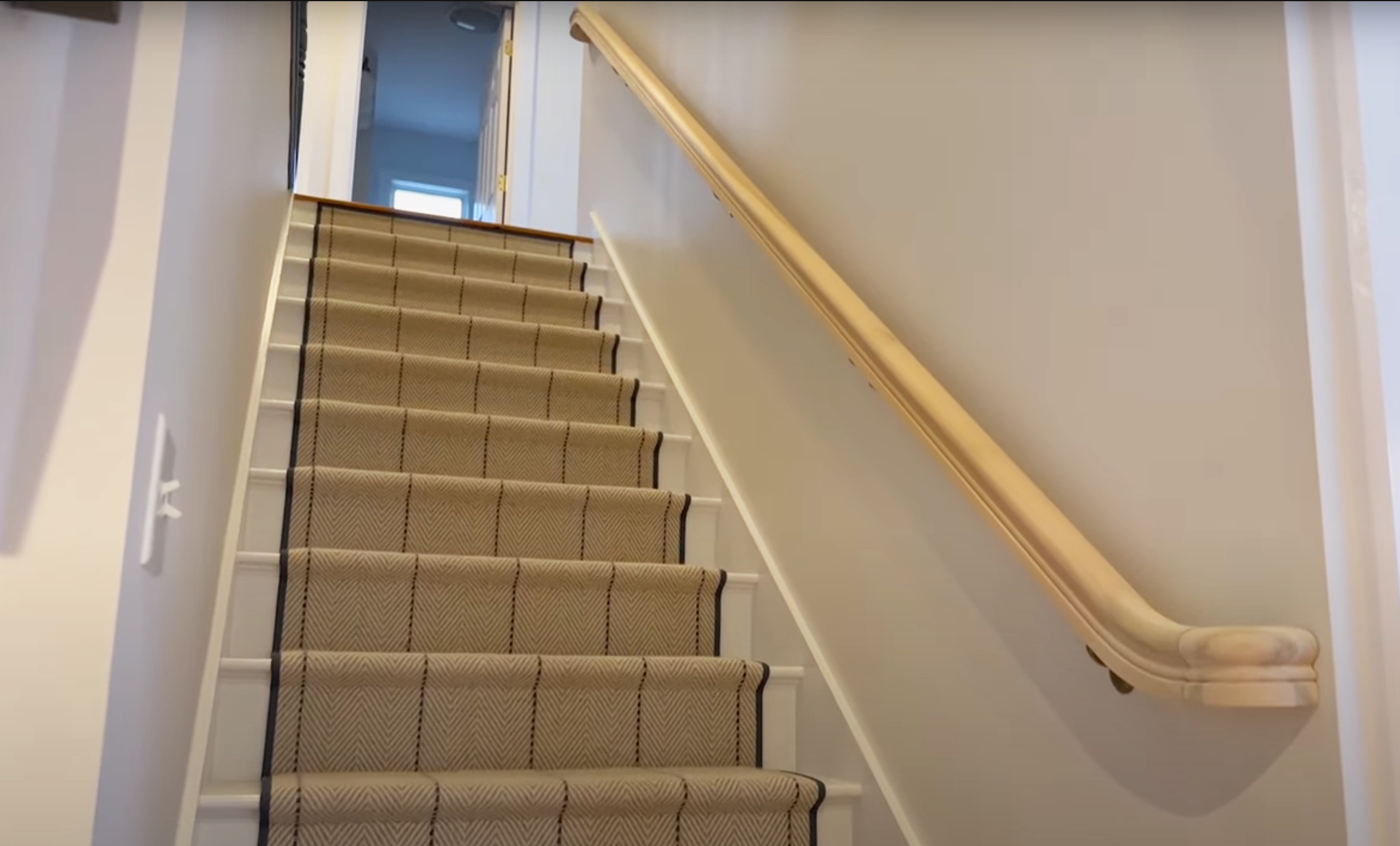

John Sweeney, from the SOLIDWORKS R&D team, and his wife Ann-Marie have spent decades restoring their historic home in coastal New England. Over the years, they’ve made regular trips to a local architectural salvage store, collecting everything from hooks and handles to newel posts used in earlier stairway renovations.
During one of their visits to the shop, they found a red railing tucked away that they both loved. They worked to restore it, raise the height, and installed two sections of the antique railing along the top of their staircase. However, they also needed a handrail to cover the 14-foot stretch of stairs. They decided to have a custom handrail made to match the antique profile. When John picked up the order, he discovered that the handrail fittings, curved returns, and other essential pieces were missing. Ordering these items separately would have tripled the cost, so he began shaping them by hand, which significantly slowed the project’s progress.

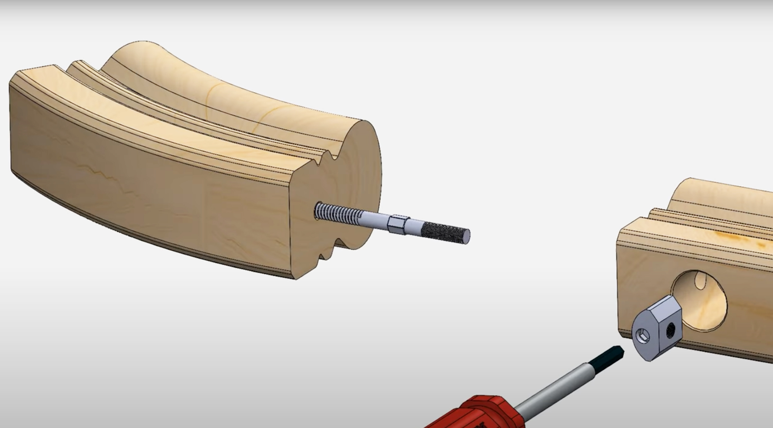

The first step in working on the handrail was to scan the original piece to create a precise digital model. While the scan provided a good reference, it wasn’t ideal for the fine-tuning that the project ultimately needed. Instead, they took a more hands-on approach. They traced the shape of the original railing, modeled it in CAD, and 3D-printed test pieces to refine the profile. After a few iterations, they had a design they were happy with.

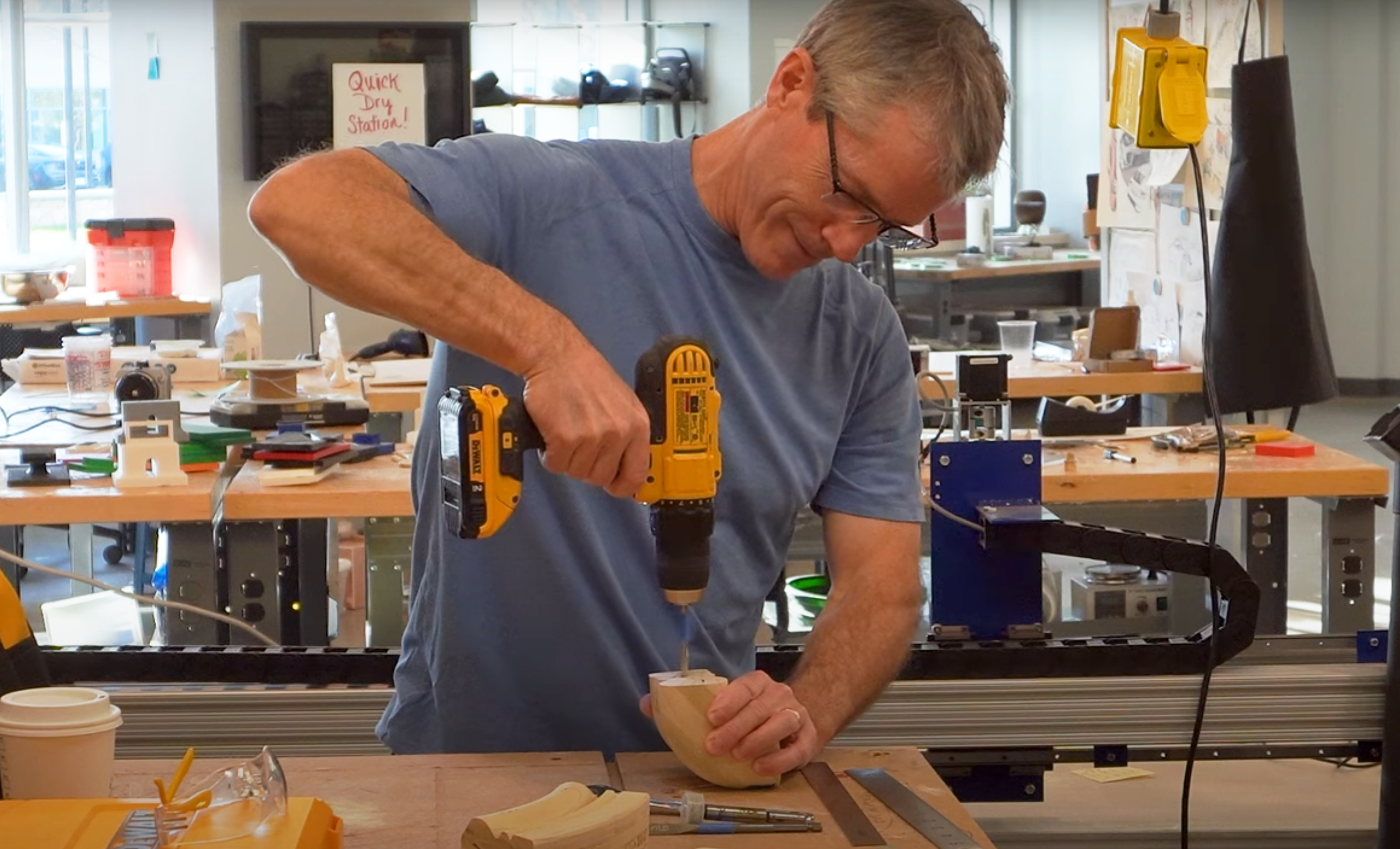

Machining the railing was the next challenge. Because the piece had detailed curves on multiple sides, it required a two-step machining process. First, they clamped it down and machined one side. Then, they flipped it over, re-clamped it, and machined the other. Everything needed to align perfectly for a smooth result. The biggest challenge didn’t end up being the machining; they discovered that the newly purchased handrail John bought was not symmetrical. One end was slightly smaller than the other. Luckily, they caught this issue by using a series of 3D-printed samples to test slight profile variations, bringing each one back and forth to compare until the fit was right.

Even with modern CNC tools, some details still require finishing by hand. The curved returns, the 90-degree transitions at the ends of the handrail, were particularly tricky. Standard cutting tools were unable to shape them correctly, so the final shaping had to be done manually. Sometimes, traditional woodworking techniques remain the most effective way to achieve the details accurately.

Once the pieces were ready, installation brought its own challenges. The curved sections had to align perfectly, and the hardware needed to be positioned at just the right angles to pull everything together securely. There was some trial and error in placing the holes correctly, so that the railing sat naturally without forcing any of the joints. Fortunately, the hardware had just enough tolerance to allow for small adjustments, making it possible to fine-tune the fit as they went.
