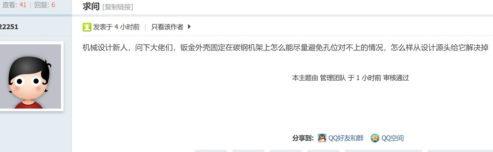

钣金外壳与碳钢机架孔位对不齐
