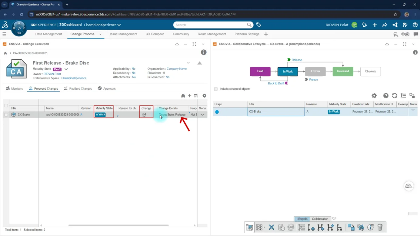

Change Execution is a smart application; based on the current maturity state of the component you add to the “Proposed Changes” area, it automatically shows you what the result of this operation will be (Target State).
First Release Scenario:
If your part’s maturity state is “In Work,” the Target State field automatically becomes “Released,” and a Lifecycle icon appears in the Change column.

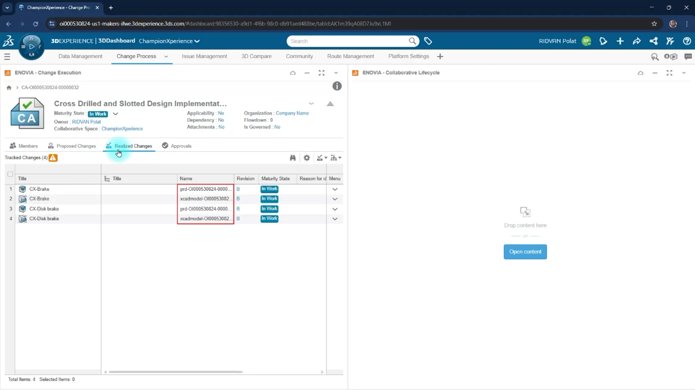

Realized Changes
When the CA is started, components added to the Proposed Change area appear in this area with their new states based on their target states.

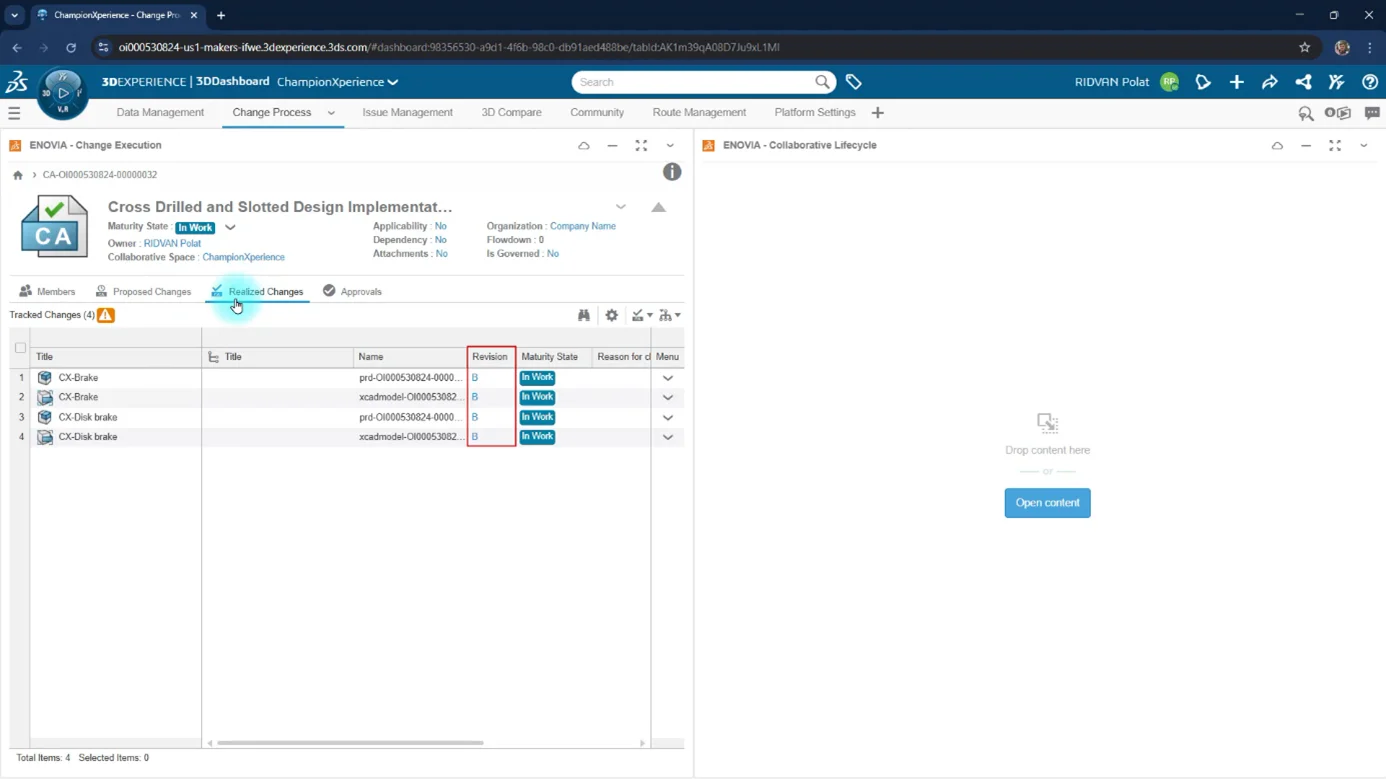

Automatic Revision Creation: One of the biggest conveniences provided by the application is automation. If the part is in the “Released” state and you move the CA from the “Draft” stage to the “In Work” stage, a new revision of the part is automatically created and added to the Realized Changes tab. You do not need to manually create a new revision.

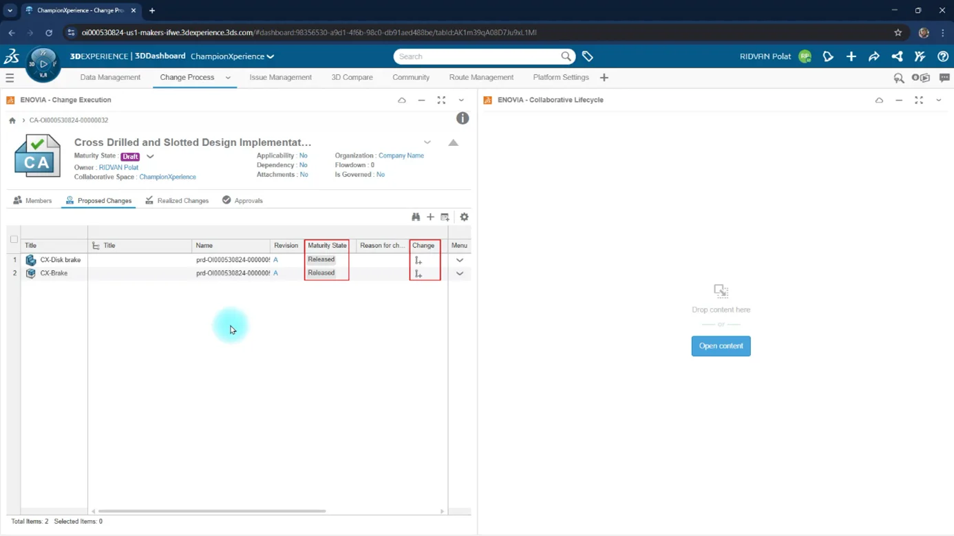

Similar automation exists for the First Release process as it does for revisions. Before submitting the CA for Approval (while in the In Work state), when the maturity state of the component in the “Proposed Changes” area is raised to the Frozen level, you can see that the Frozen components appear in the Realized Change area, and these components will become Released upon completion of the CA process. This way, you don’t need to manually change the Maturity states.
As a note, if you want to further automate the process, you can ensure the Frozen action happens automatically, as well. Thanks to the option shown in the image, when you select In Approval, you can ensure that components added to the Proposed Change area are automatically Frozen. But it’s worth remembering that this option only processes based on what you added to the Proposed Changes area. For operations like adding all components under an assembly, you need to use the Lifecycle.

When you examine the image carefully, you will notice that some file names say prd while others say xcadmodel.

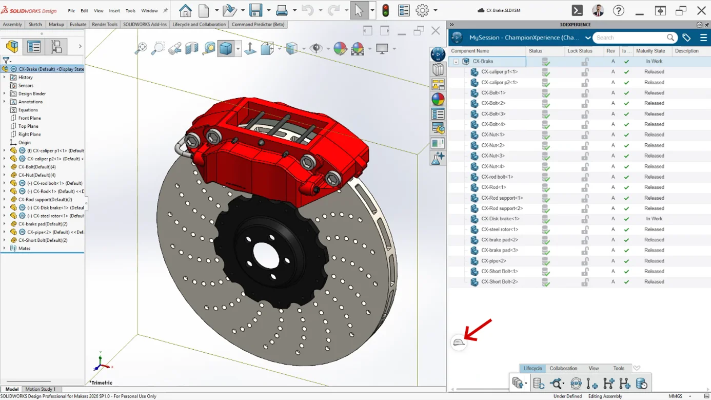

Work Under
This feature is the bridge between the CA you created and the CAD data. It has a hardhat-like icon.
When Work Under is active:
Every change you make is recorded in the background.
It provides retrospective traceability and guarantees that the process is carried out in a controlled manner within that change package.

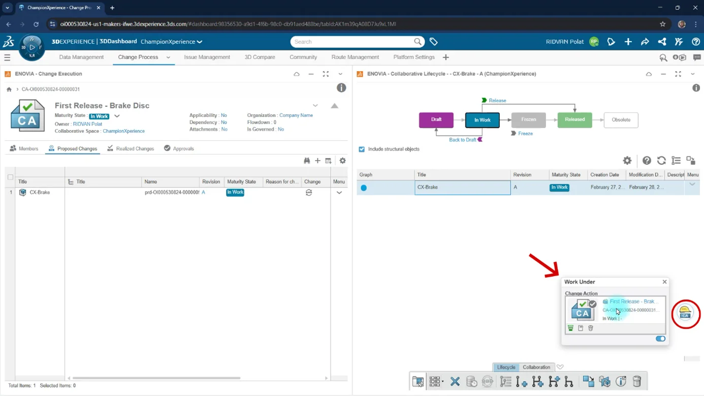

How to Use Work Under
When you click on the hardhat icon, the Change Action button appears as shown in the picture above. When you click this button and select the relevant CA, the hardhat icon turns into the state shown with the red circle in the picture. When you click the icon again, you can also see the information of the CA it is connected to.
You can see the Work Under feature in many applications. For example, you can see it in the 3DEXPERIENCE window in SOLIDWORKS and in the Collaborative Lifecycle widget.

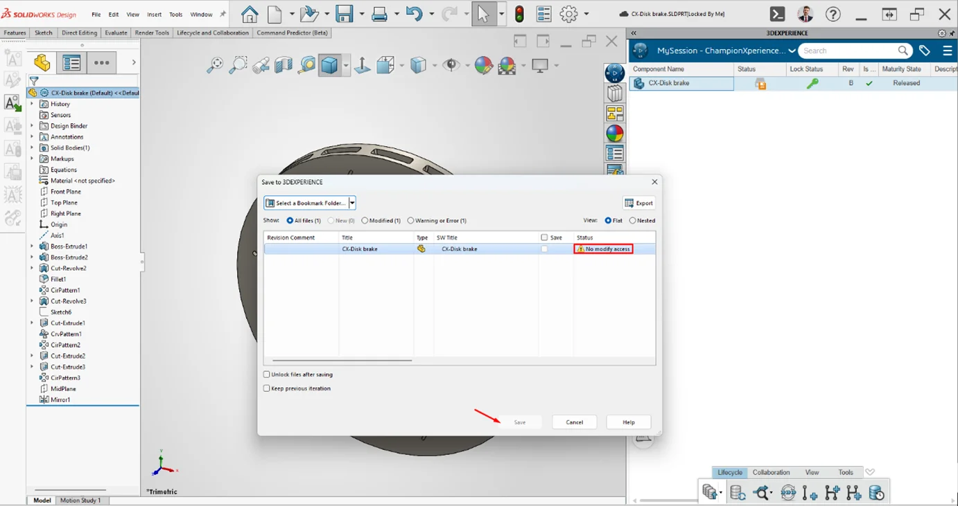

If you do not connect the CA to Work Under after adding a component to the CA, the system will not allow you to save the changes you make on the component. Thanks to this feature, it prevents uncontrolled changes. The warning in the picture saying Locked by action “Tst-002” gives the user this information: This component is connected to a CA named Tst-002. If you do not perform your operations using Work Under, you cannot Save.
When you connect the CA to Work Under, you can see that the Save button is both active and has the Active Work Under icon next to it.

Also, you can see some commands located in the Action Bar in the 3DEXPERIENCE Window in SOLIDWORKS. In this way, you can perform many operations like changing Maturity status and creating Revisions directly via SOLIDWORKS without going to the browser screen.
If we proceed through SOLIDWORKS
When you create a new part, the initial maturity in its lifecycle is usually In Work. In the In Work state, you can make changes on your part and save it.
When you set the Maturity state to Frozen, you cannot perform any operations on the part; it becomes read-only. This is preferred when the design needs to be reviewed.
When you set the Maturity state to Released, it indicates that your part/assembly is now approved and ready for production. Now, even if a change is made to the data, it will not be allowed to be saved. Trying to save brings up the use of revision.
